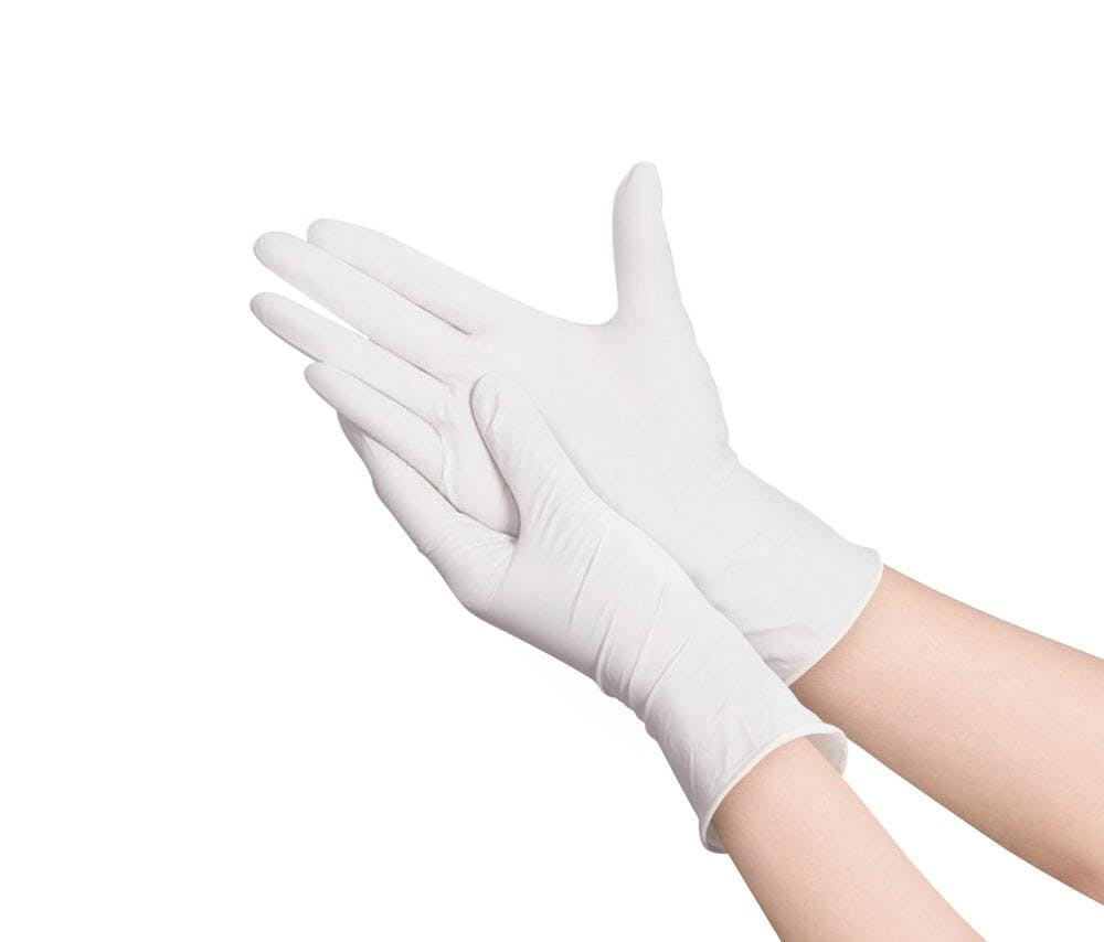

white latex gloves
White gloves made of latex.
