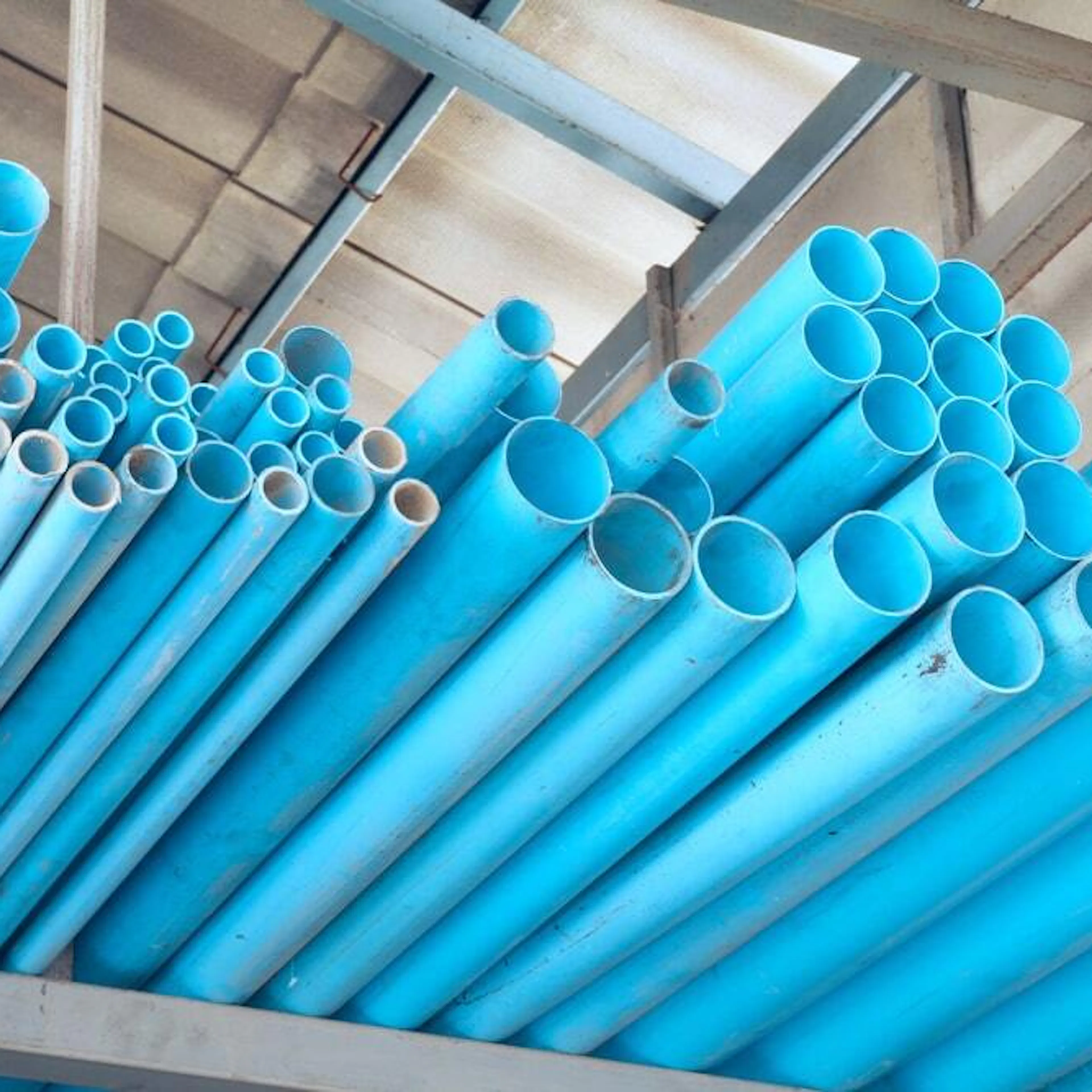

PVC is an engineering thermoplastic with excellent resistance to moisture ingress and UV (ultraviolet light). Its good abrasion resistance makes it a popular choice for piping and construction materials. PVC is generally available in two forms, namely plasticized (PVC-P) and unplasticized (PVC-U). Unplasticized PVC is used in parts that require rigidity, like pipes and fittings. Plasticized PVC is used in applications that require flexibility, like cables, tubes, and PPE (personal protective equipment). Modified grades of PVC are available, which have various additives to improve PVC properties,  such as overall strength. These grades are referred to as PVC-M (Modified). PVC can be melt-processed using injection molding, extrusion, and blow molding. Additionally, PVC pipes and fittings can be bonded with glue.
Figure 1 is an example of PVC pipes:
PVC pipe
PVC pipe
