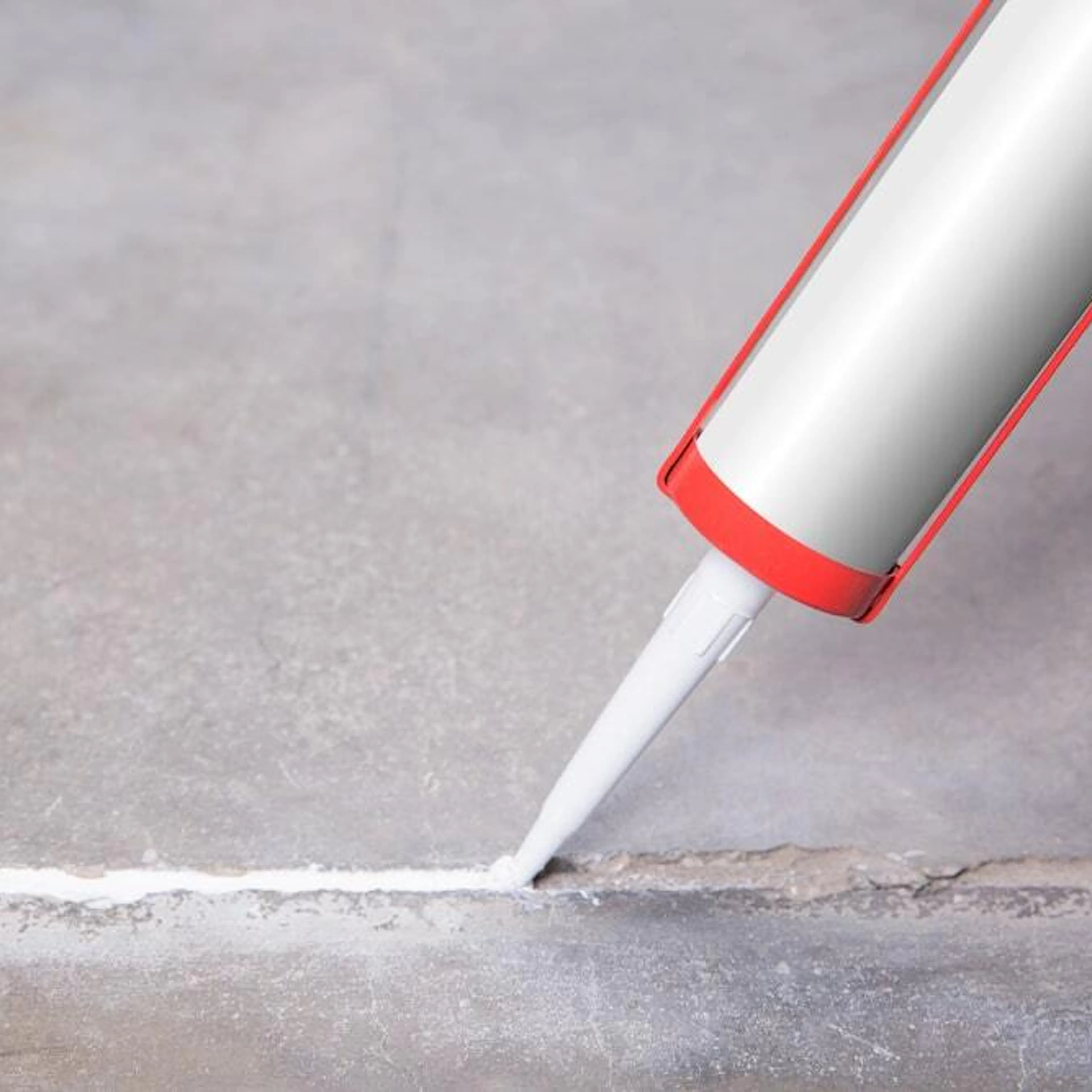

Filling in a crack with silicone sealant. Image Credit: Shutterstock.com/Dimik_777

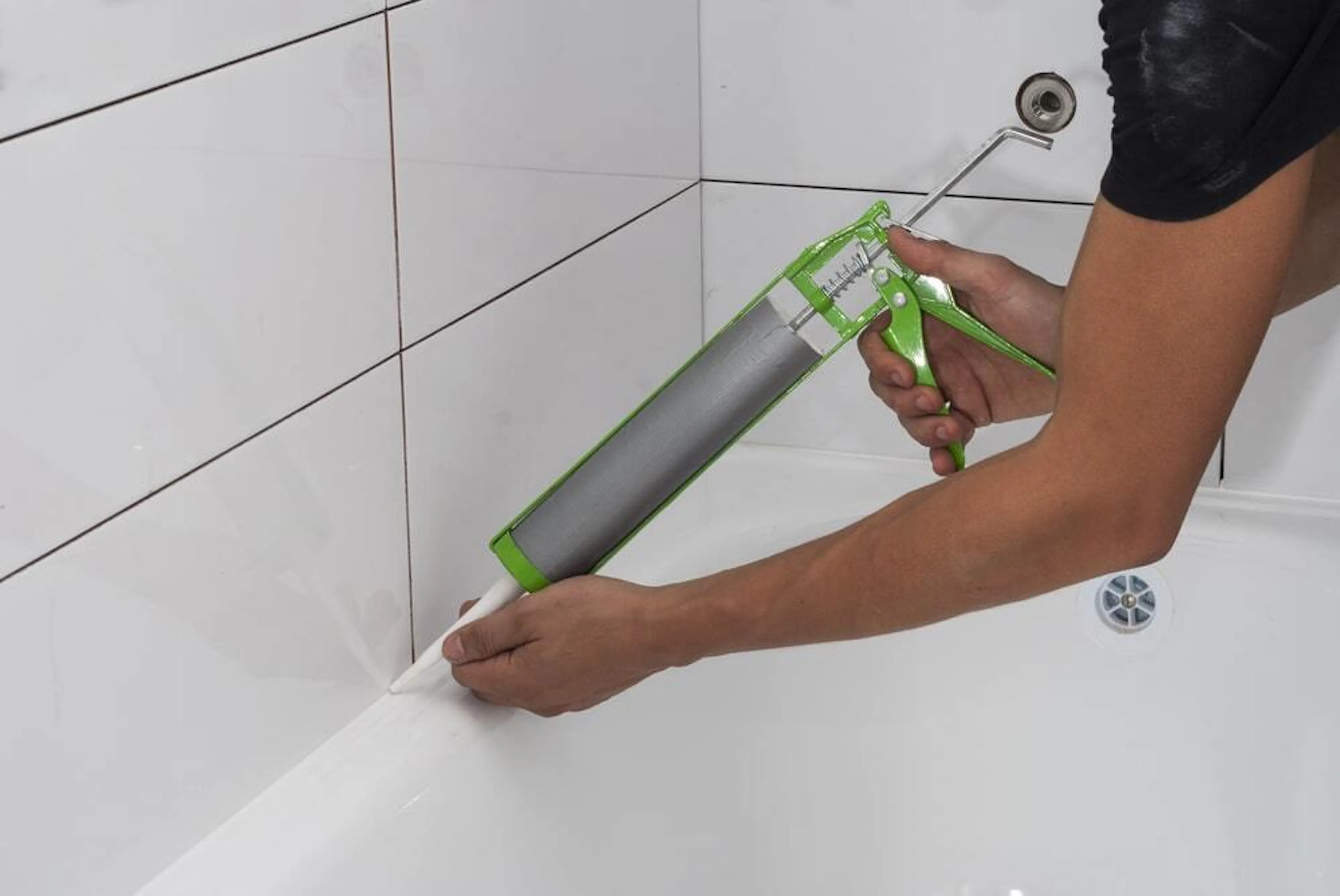

RTV-1 is supplied ready to use. Once applied, a stabilizing agent in the silicone quickly begins to react with moisture in the air, curing the outside. Several different types of cross-linking agents are used. Some give off small amounts of acetic acid, amines, or alcohols while setting, while others are odorless. RTV-1 silicones are valued for their ease of use, good adhesion, and stability at high temperatures. Typical applications include use as sealants, bonding glues, and coatings. The image below shows RTV-1 used as a sealant:
RTV-1 being used as sealant in a bathtub.
Image Credit: Shutterstock.com/Kuchina
