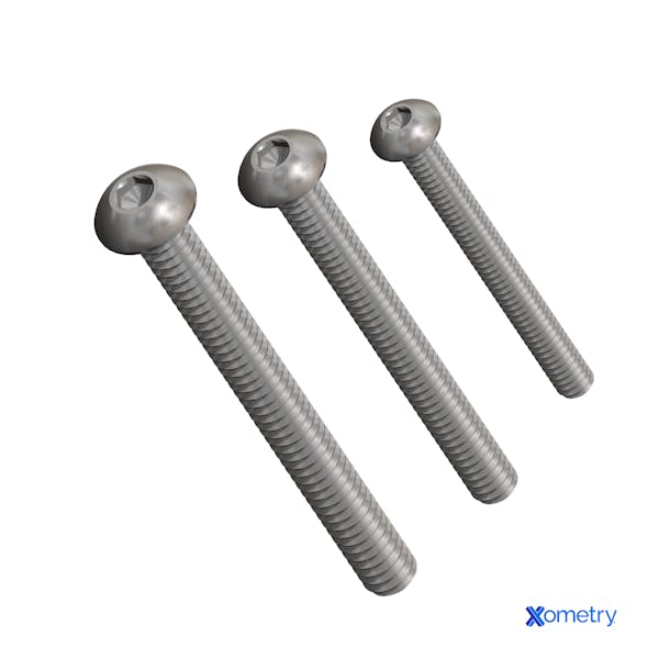

There are a few materials out there that have gained so much popularity, they’re essentially household names, and one of those happens to be stainless steel. This well-known family of carbon steel alloys, which is practically the celebrity of metals, can be parsed out into five different groups and then broken down further into a ton of grades. This is what it looks like:
stainless steel bolts
In this article, we break down the different types of stainless steel, as well as an overview of more than 35 grades. If you work with this metal a lot (or plan to) you might want to bookmark this page.

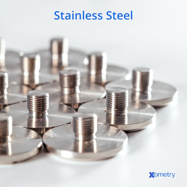

Below you can see another picture of machined parts made of stainless steel parts that we’ve made here at Xometry.
Stainless steel machined parts from Xometry
