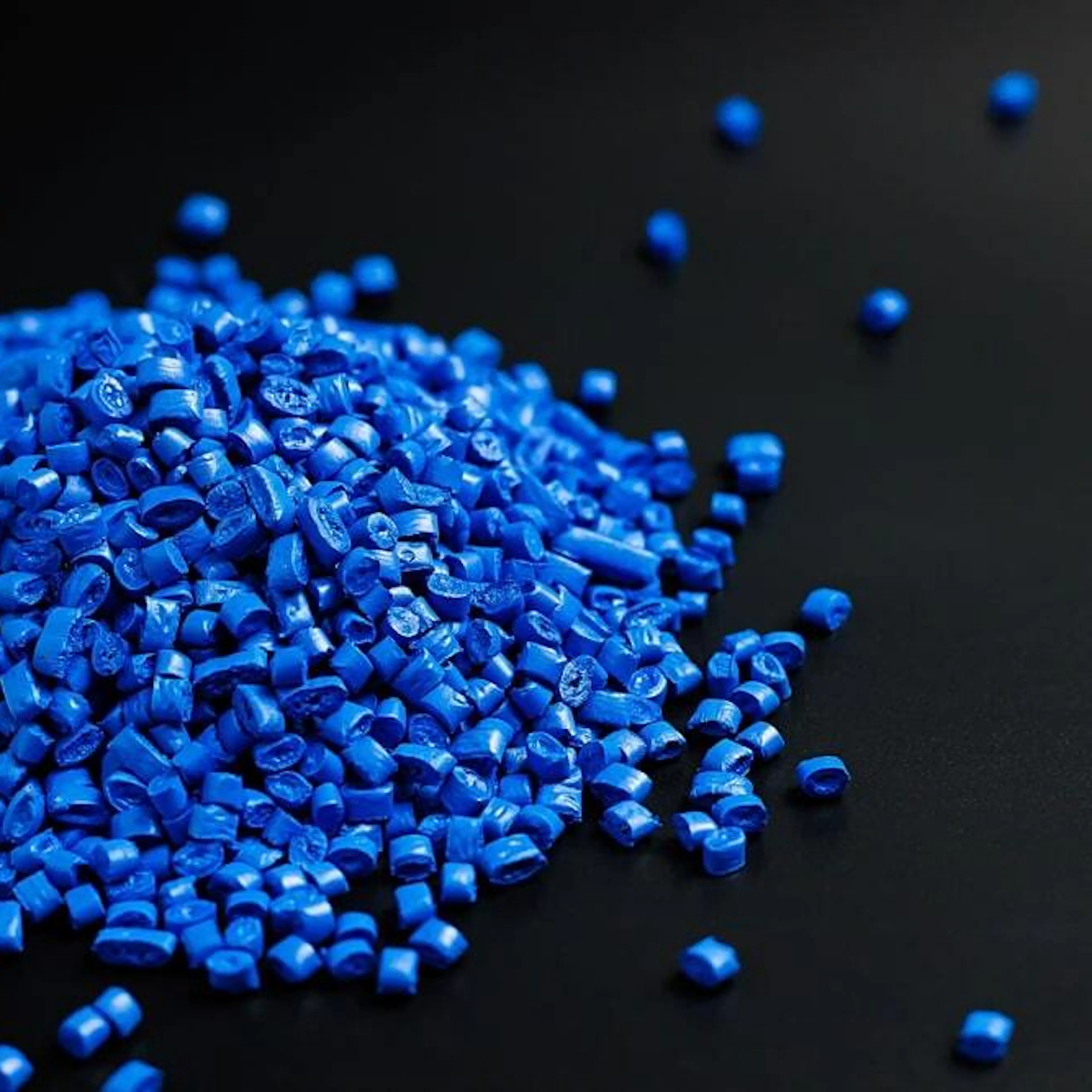

Blue granules of polypropylene. Image Credit: Anastasiia Burlutskaia/Shutterstock.com

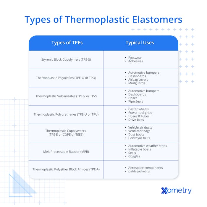

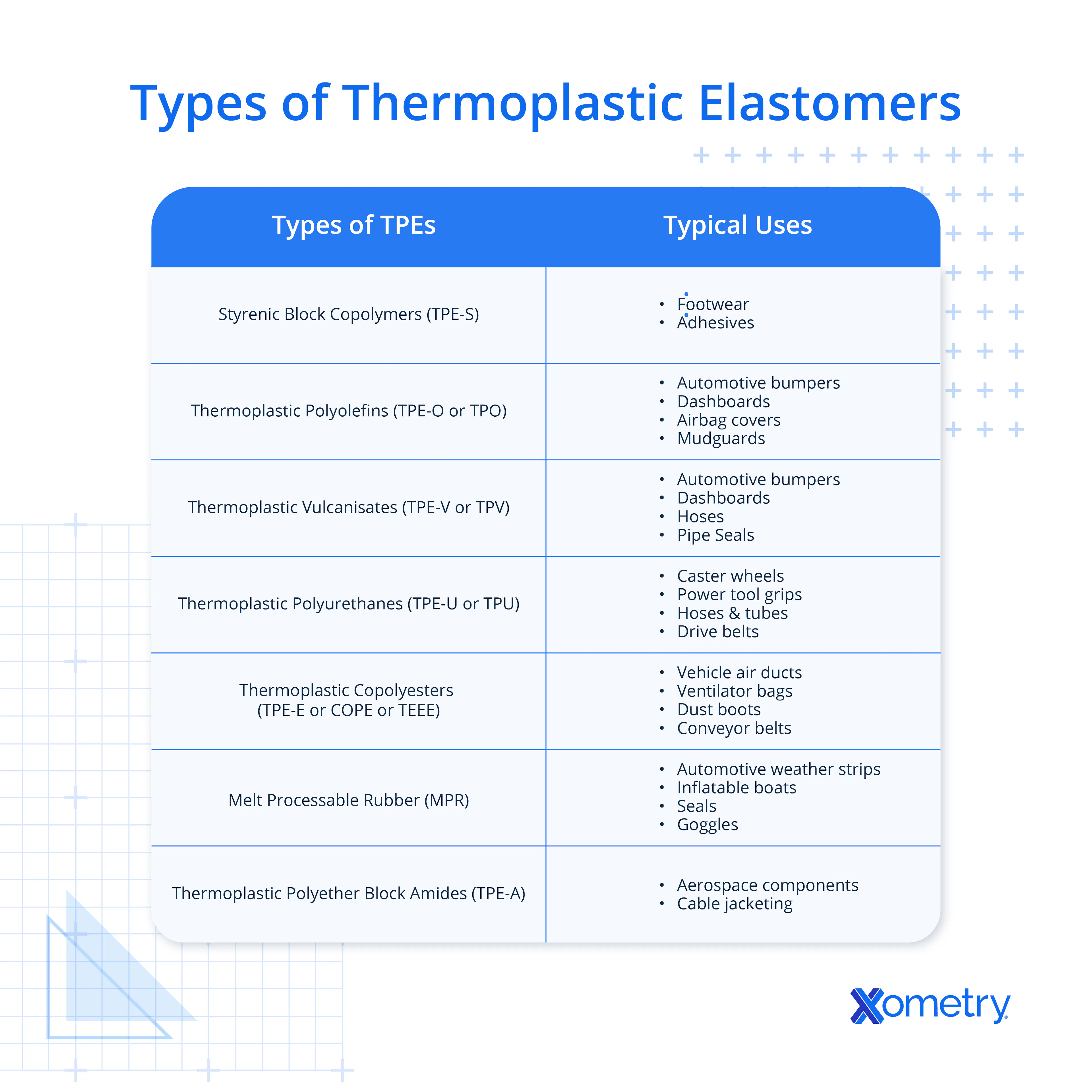

Table 1 below summarizes the types of thermoplastic elastomers:
thermoplastic elastomer types
Types of thermoplastic elastomers
