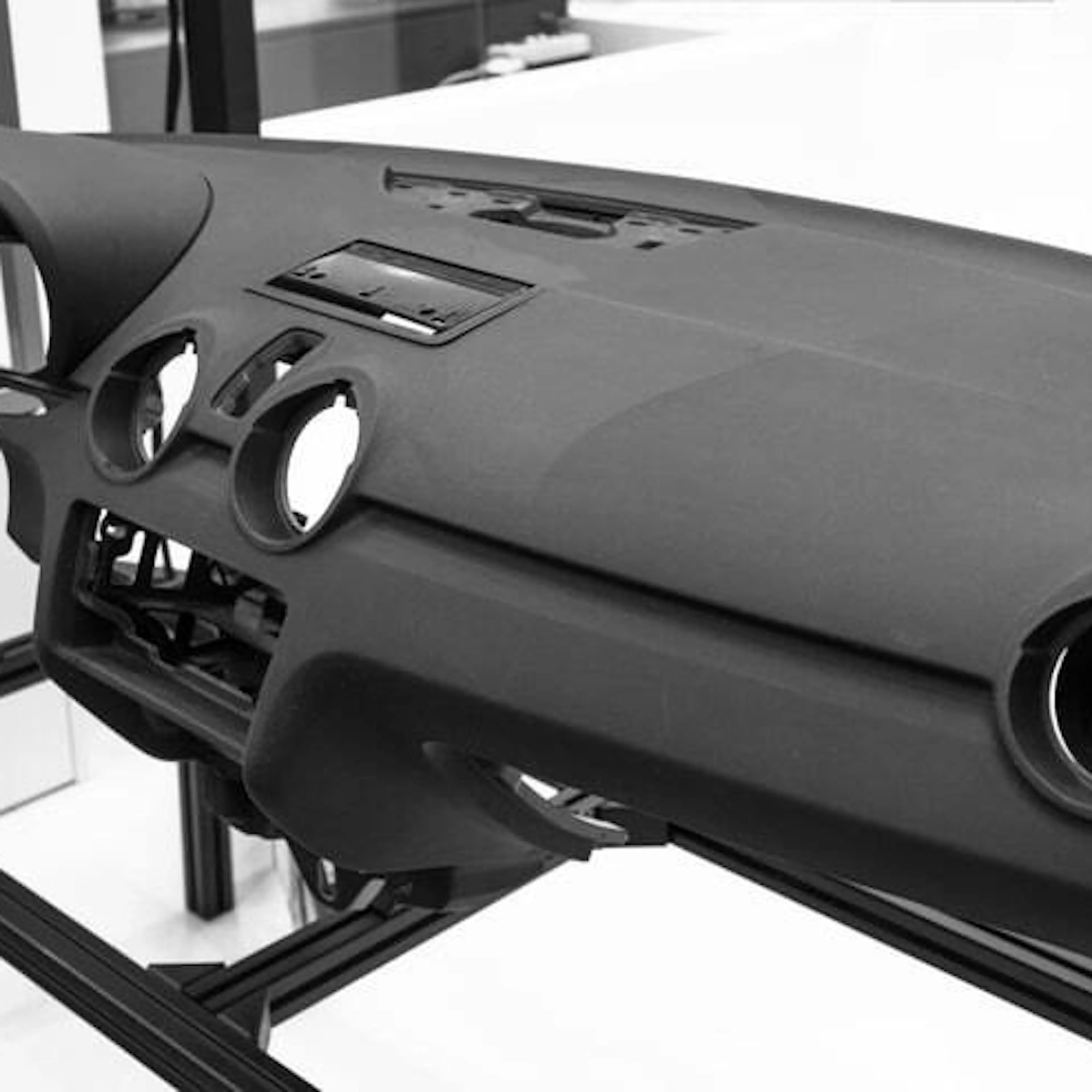

Car dashboard on a white background. Image Credit: patruflo/Shutterstock.com
PPE-PS is a ductile material with excellent hydrolytic stability, flame resistance, and UV resistance. These properties make it ideal for applications in the process engineering, electrical, and medical industries. PPE-PS can be processed using injection molding, extrusion, blow molding, and 3D printing. It has a very high melting temperature of over 200°C and must be heated to over 300°C if processed using 3D printing.

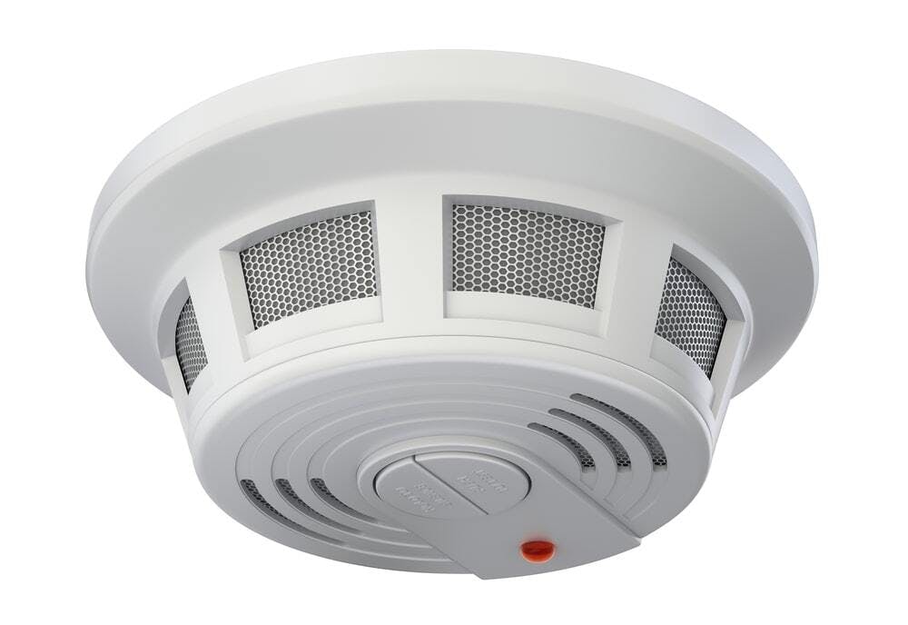

Processing techniques for PPE-PS include: injection molding, blow molding, extrusion, and 3D printing. The image below shows a smoke detector casing made from PPE-PS:
smoke detector on white background
Smoke detector on a white background.
Image Credit: mipan/Shutterstock.com
