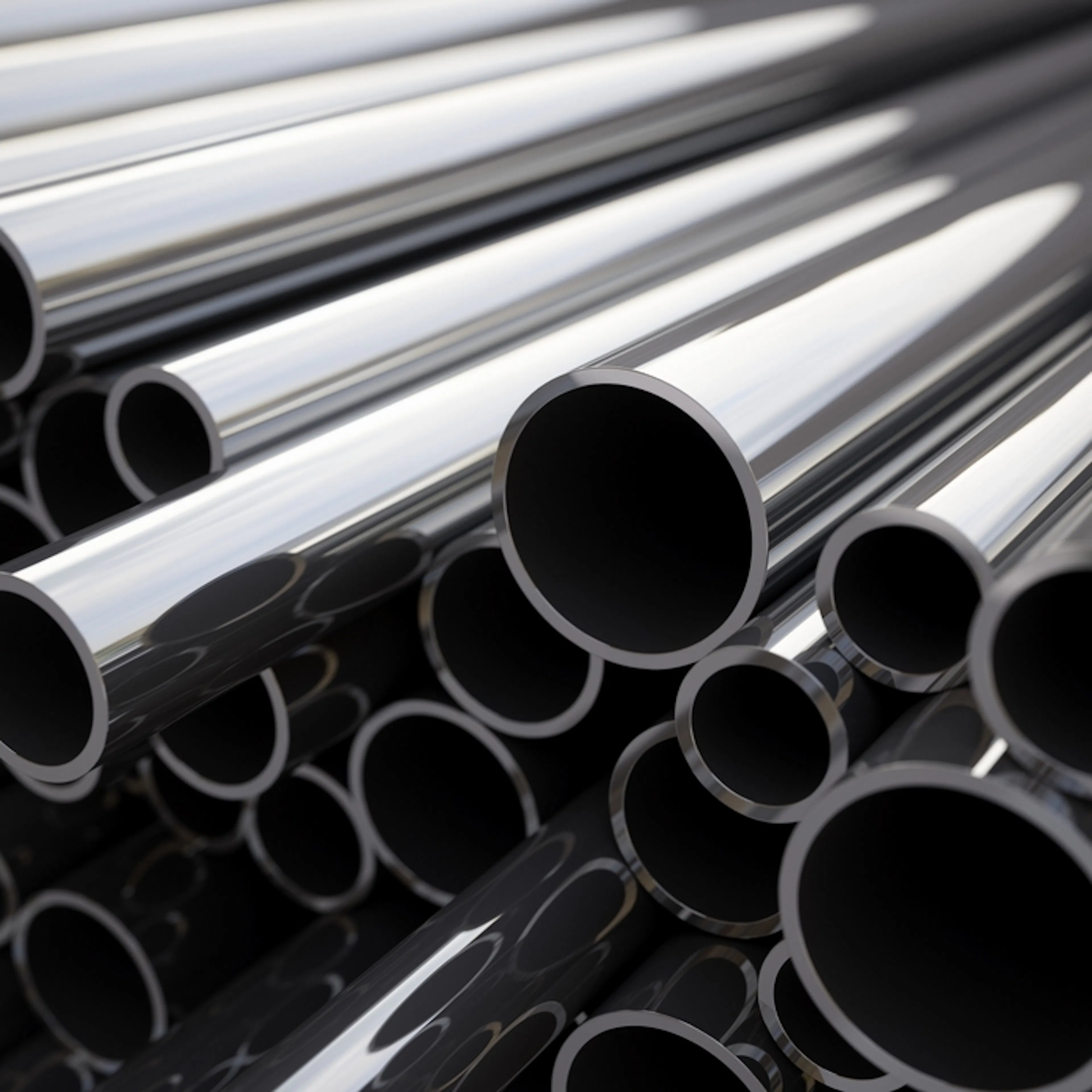

Stainless steel pipes. Image Credit: Shutterstock.com/CHIARI VFX
Stainless steel is an alloy composed of iron and at least 10.5% chromium for corrosion resistance and durability. The chromium reacts with oxygen to form a thin, stable oxide layer that protects against rust and surface degradation. Nickel, molybdenum, and manganese improve toughness, ductility, and resistance to pitting and oxidation in specific grades. Stainless steel maintains a non-reactive surface, making it suitable for applications requiring hygiene and chemical stability. The material's combination of mechanical strength, heat resistance, and aesthetic appearance supports its use in construction, automotive, medical, and food processing industries. Different grades of stainless steel offer varying balances of properties like corrosion resistance, hardness, and ductility, making SS metal versatile for industrial and structural purposes. The type of steel refers to different categories and grades of steel, including stainless steel, each designed for specific applications.

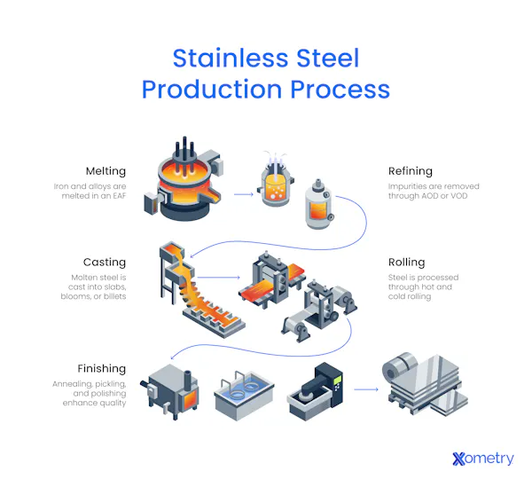

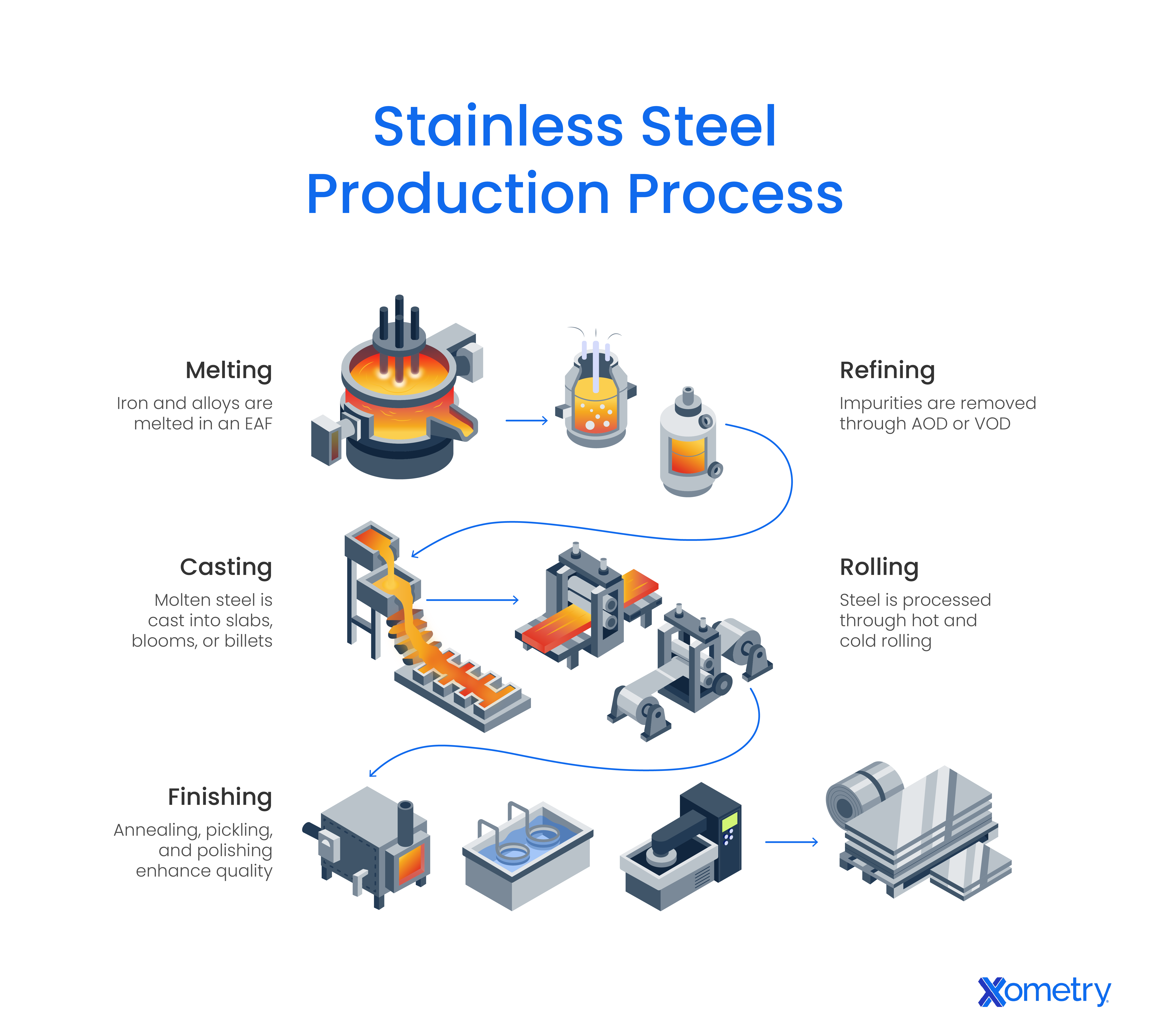

How is Stainless Steel Made?
Stainless steel is produced by melting iron with alloying elements such as chromium, nickel, and molybdenum, typically in an electric arc furnace or induction furnace. Chromium forms a protective oxide layer that resists corrosion, nickel increases toughness and ductility, and molybdenum improves strength and resistance to pitting. Molten steel is refined through Argon Oxygen Decarburization (AOD) or Vacuum Oxygen Decarburization (VOD) to remove impurities and stabilize the alloy composition. The refined metal is cast into slabs, blooms, or billets and then processed through hot and cold rolling to achieve the desired dimensions. Annealing relieves internal stresses and restores corrosion resistance, followed by pickling and polishing to remove surface oxides and produce a bright, clean finish. The stainless steel production process ensures uniform composition and strength through precise control of alloying and refining stages. The stainless process maintains durability, surface quality, and corrosion resistance for industrial and structural applications.

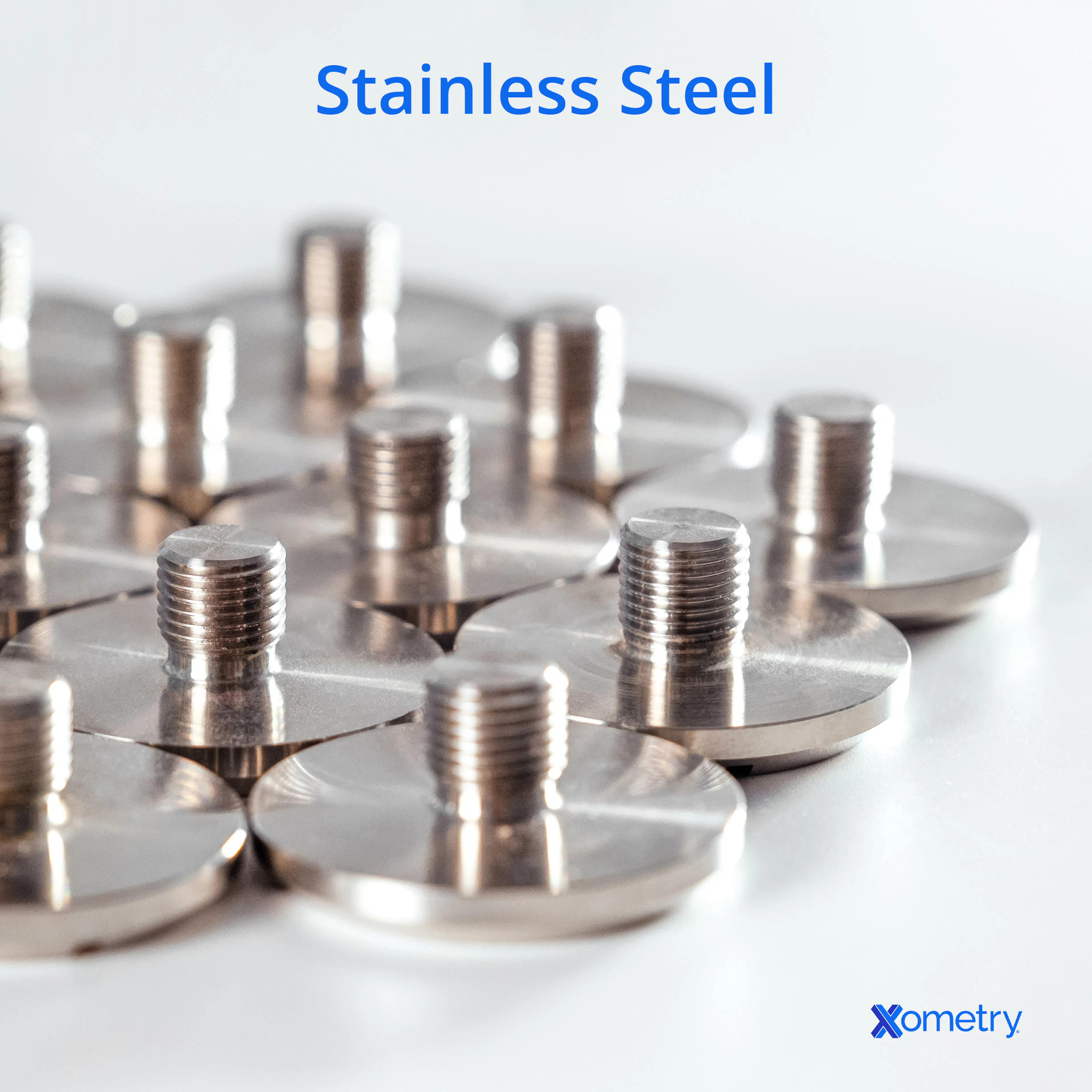

Stainless steel parts
