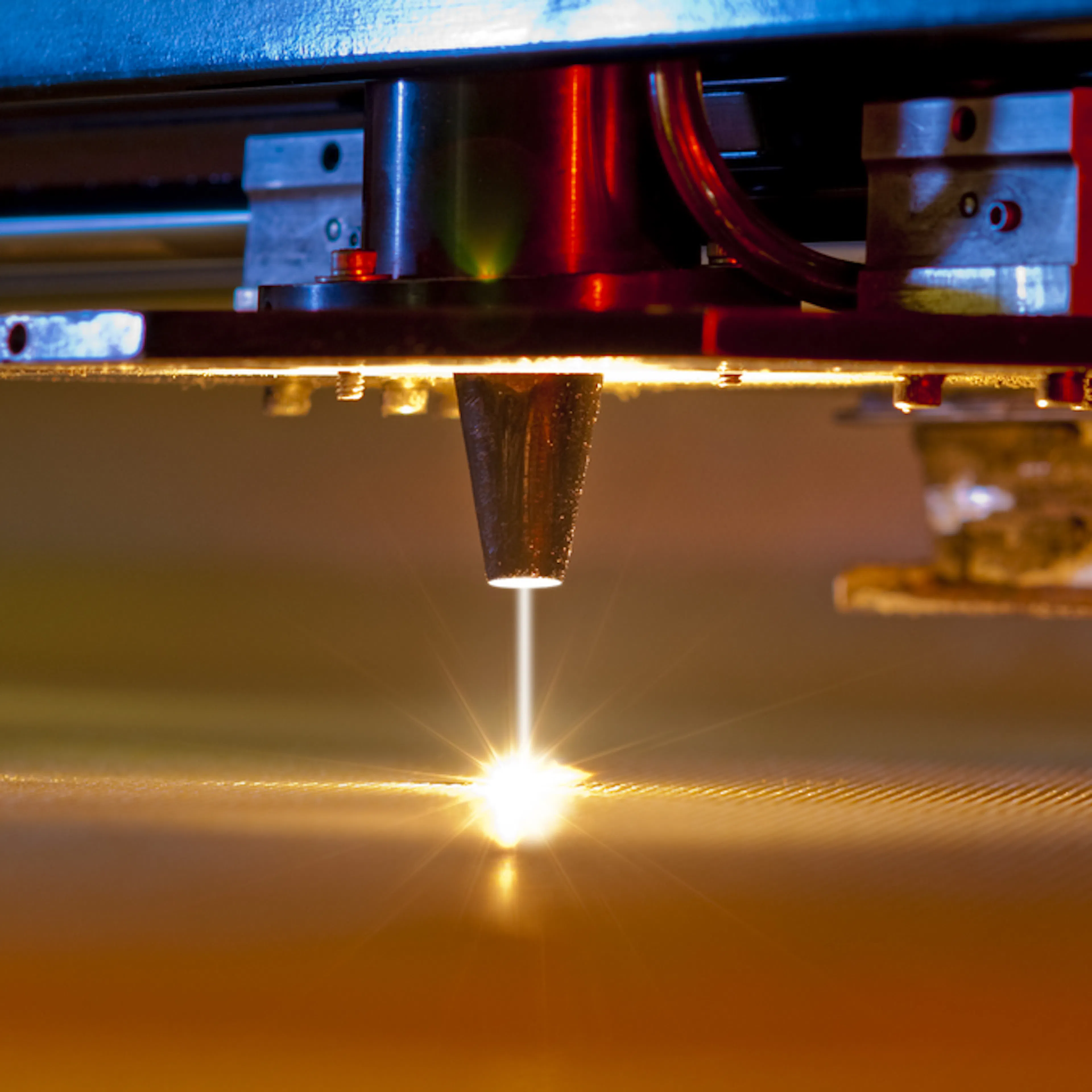

Industrial laser cutting machine. Image Credit: Shutterstock.com/Christian Delbert
