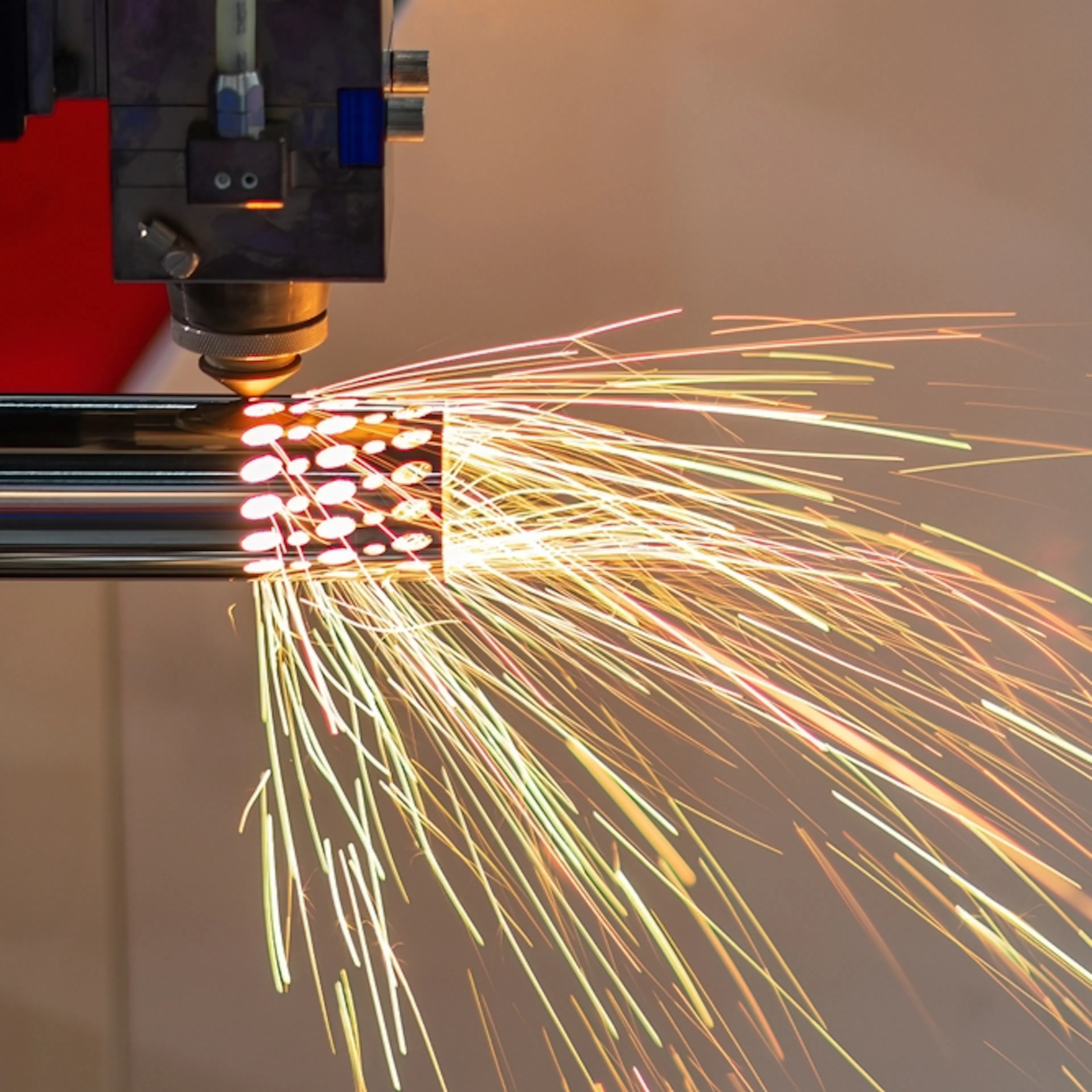

Fiber laser cutter. Image Credit: Shutterstock.com/Pixel B
Manufacturers around the world love fiber lasers, and so do many of our customers—but this doesn’t come as a surprise. These lasers have extremely high optical gain, even able to produce a kilowatt of continuous output power. They are very accurate, even on complex designs, and don’t really leave behind any burns, rough edges, or thermal deformation. Because the beam is produced in the fiber’s small core, it doesn’t require a separate optical medium making it very stable and simple to maintain, as well as high in quality and straight, without much diffraction. They have fairly low operating costs, and there are no blowers or moving parts—another plus for maintenance.
To learn more about fiber lasers, how they work, and when to use them, read on.

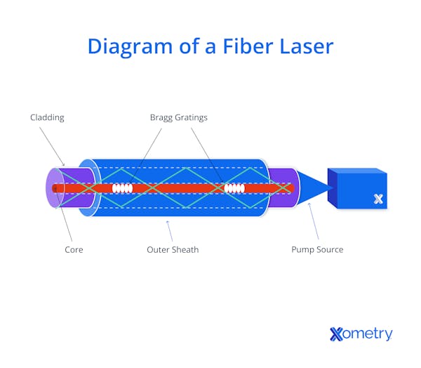

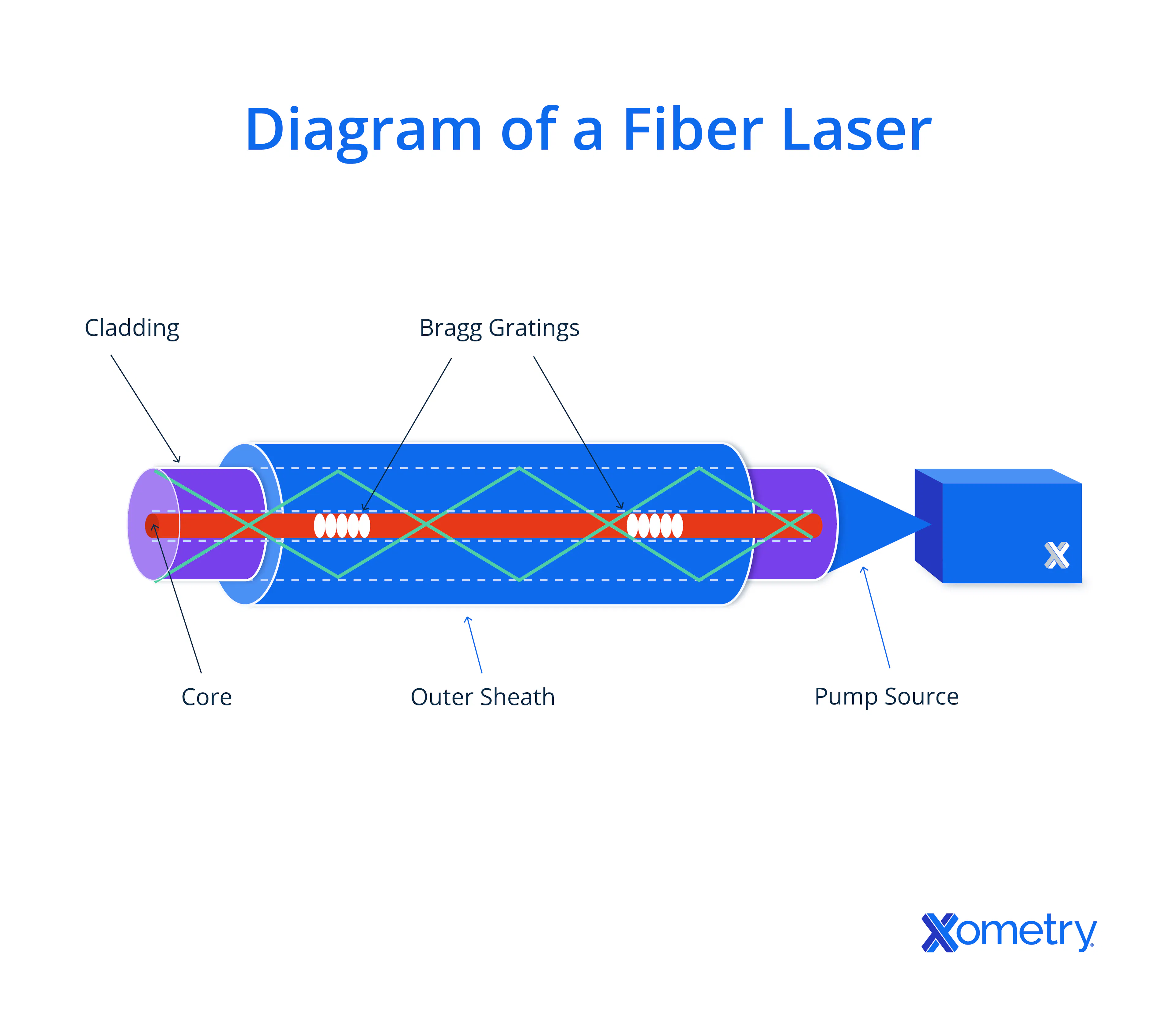

A fiber laser is a solid-state type of laser, meaning that it uses solid materials to make a beam instead of liquids or gases. The beam that comes out is extremely focused, and it works with pump laser diodes that give the laser the power to create light. A very thin optical fiber is what guides this light, which then gets absorbed and amplified into the concentrated beam. The optical fiber itself is doped, which adds a rare-earth element to it, making the process possible. Changing the doping substance, like dysprosium (2600–3400 nm), holmium (2025–2200 nm), or thulium (1900–2500 nm), will create different wavelengths. Here’s a diagram of a fiber laser:
Diagram of a Fiber Laser
You can use fiber laser beams to cut, weld, engrave, and clean materials, although it’s mostly used on metals like carbon steel, copper, and stainless steel. You can also use it on certain plastics like acrylic and polyoxymethylene, as well as graphite (but not glass fiber, leather, ceramics, polycarbonate, ABS, HDPE, polystyrene, or polypropylene foam).
Fiber lasers consist of several components that differ between types, but if we take a fiber laser cutting machine as an example, we’ll find that it’s made up of eight primary parts: the laser source, the laser cutting head, the servo motor, a cooling device, an air cutting system, a laser host (bed, beam, table, and Z-axis system), the control system, and a stabilizer. With a 30–50% power conversion rate, they’re way more energy efficient than CO2 lasers’ 10–15% (which is why they’re so often used in sectors like automotive, home appliances, fitness equipment, lighting, and decor/metal art).
They can usually be manual or automated and come in handy in so many situations, like laser marking, where 1064 nm emission wavelength ytterbium-doped fiber lasers can leave sharp and durable imprints on metal and plastic surfaces. Another is laser cleaning where they’re used to remove paint, oxide, and rust from metal surfaces. There’s also laser welding that’s fast, precise, and without much distortion, and laser cutting for difficult cuts and tight tolerances. Although operating costs are relatively low, it’s worth noting that the components can be quite pricey, and the delivery fiber can’t be separated from the source, so replacement can be tricky.
