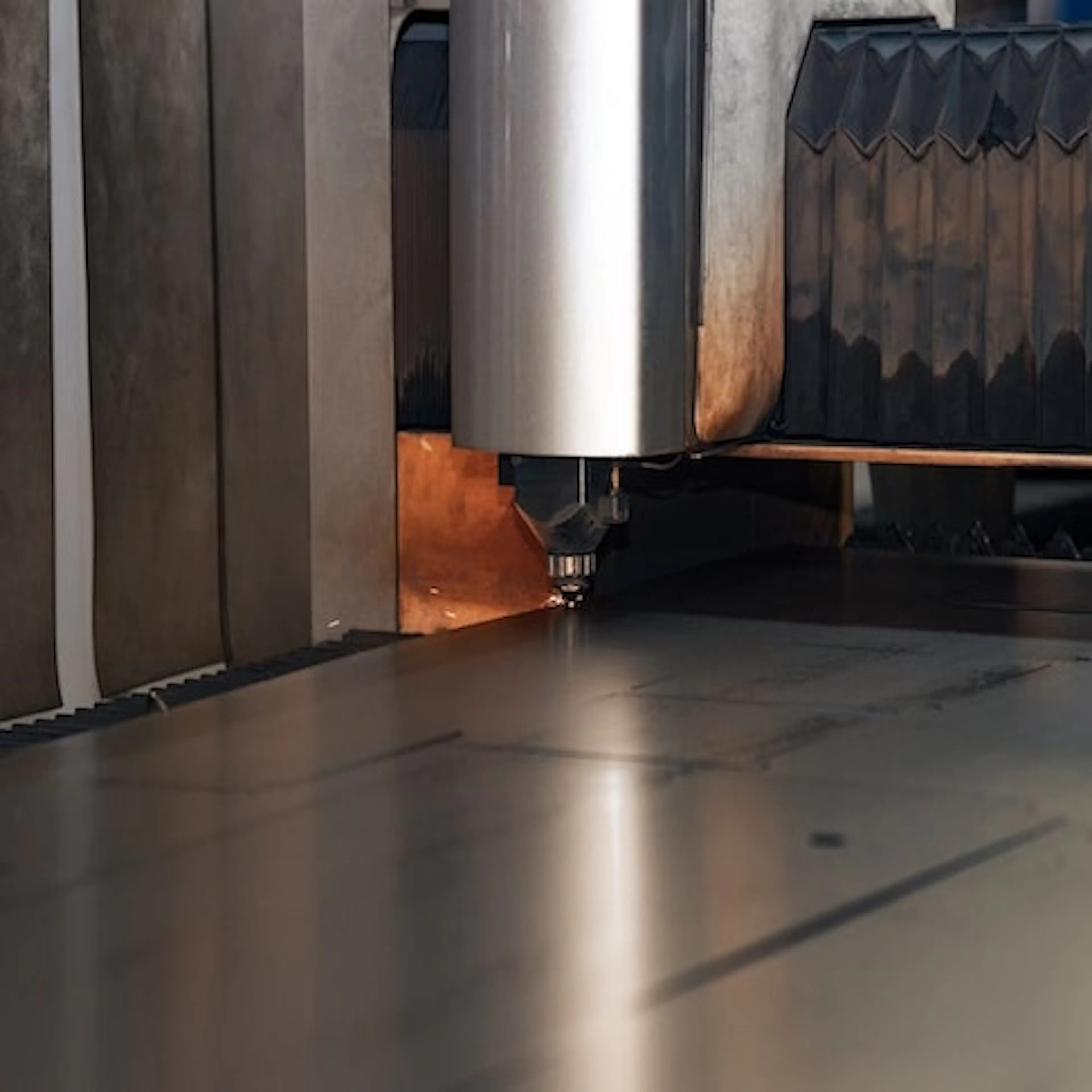

Heavy industrial laser cutter - Image Credit: Shutterstock/Evgeny Haritonov

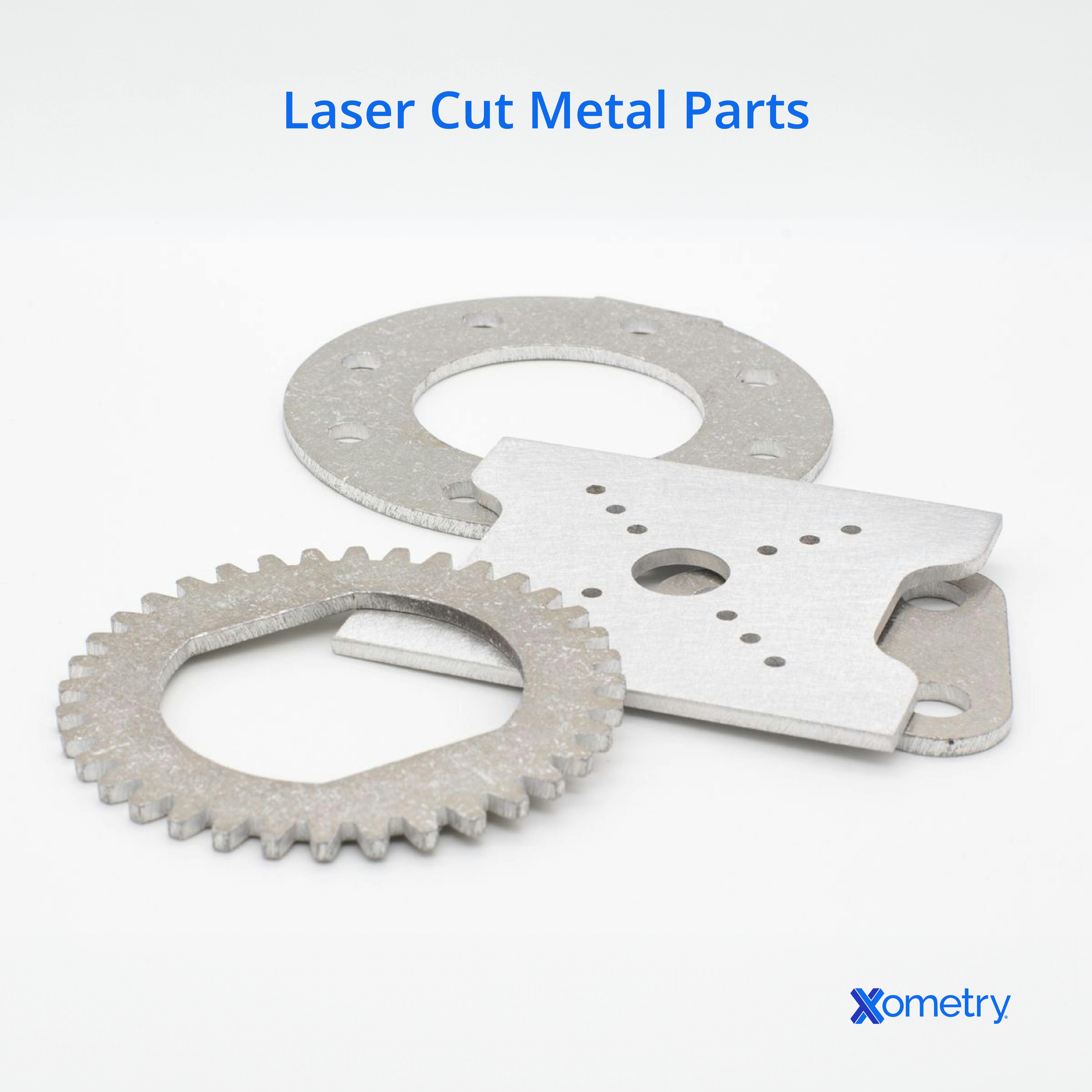

Laser Cut Metal Parts
Xometry laser cut metal parts
