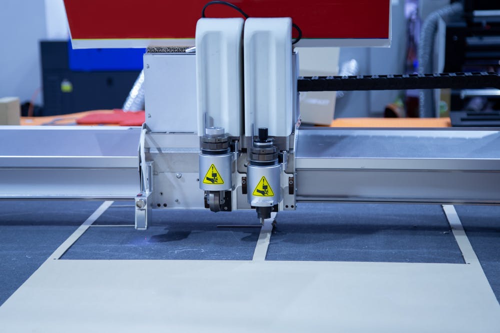

Figure 1 shows an example of a digital laser cutting machine cutting paper:
Digital laser cutter cutting paper.
Image Credit: Shutterstock.com/Itsanan
