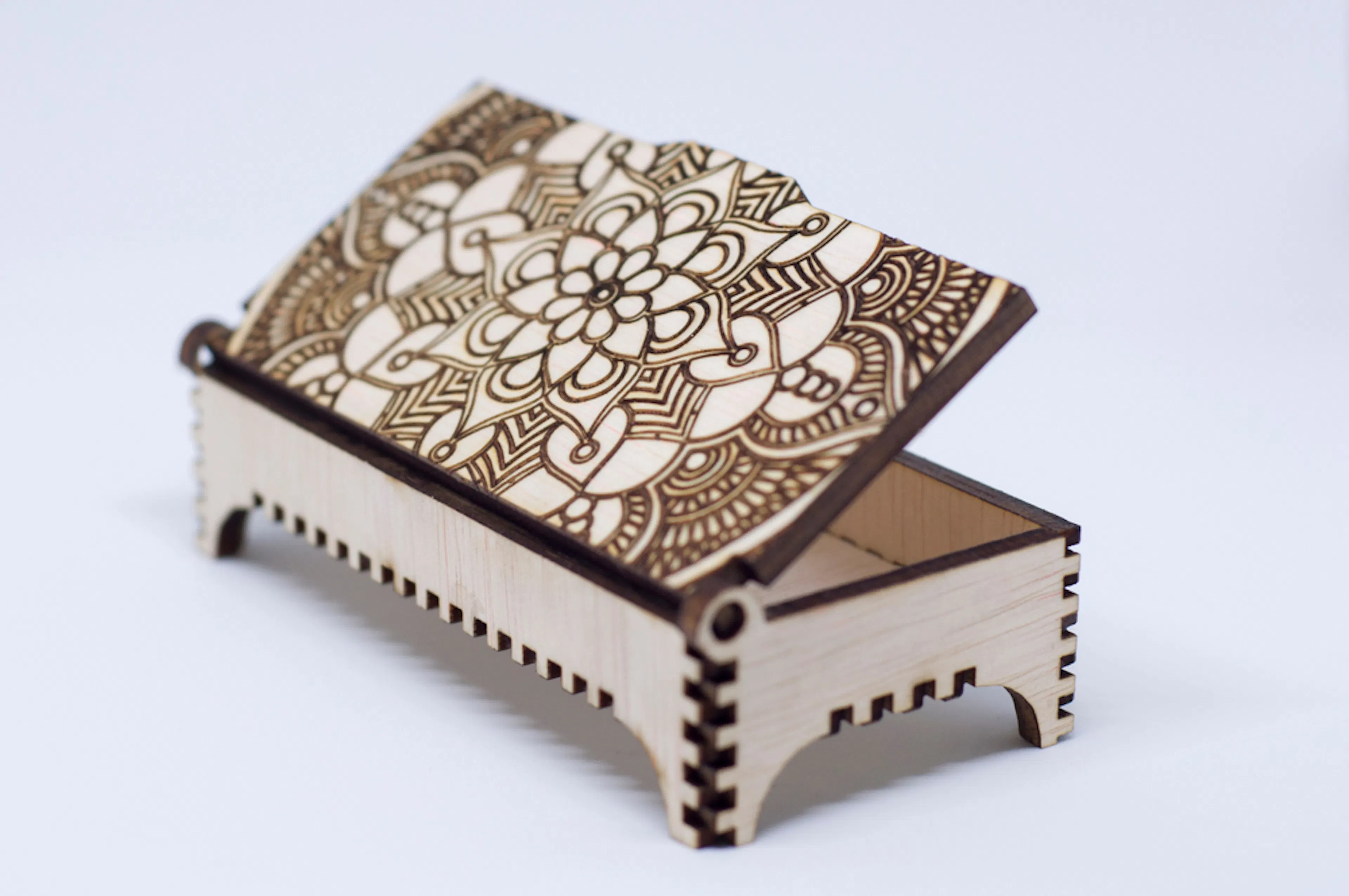

Laser engraved wooden box.
Image Credit: Shutterstock.com/Fairuzee Ramlee

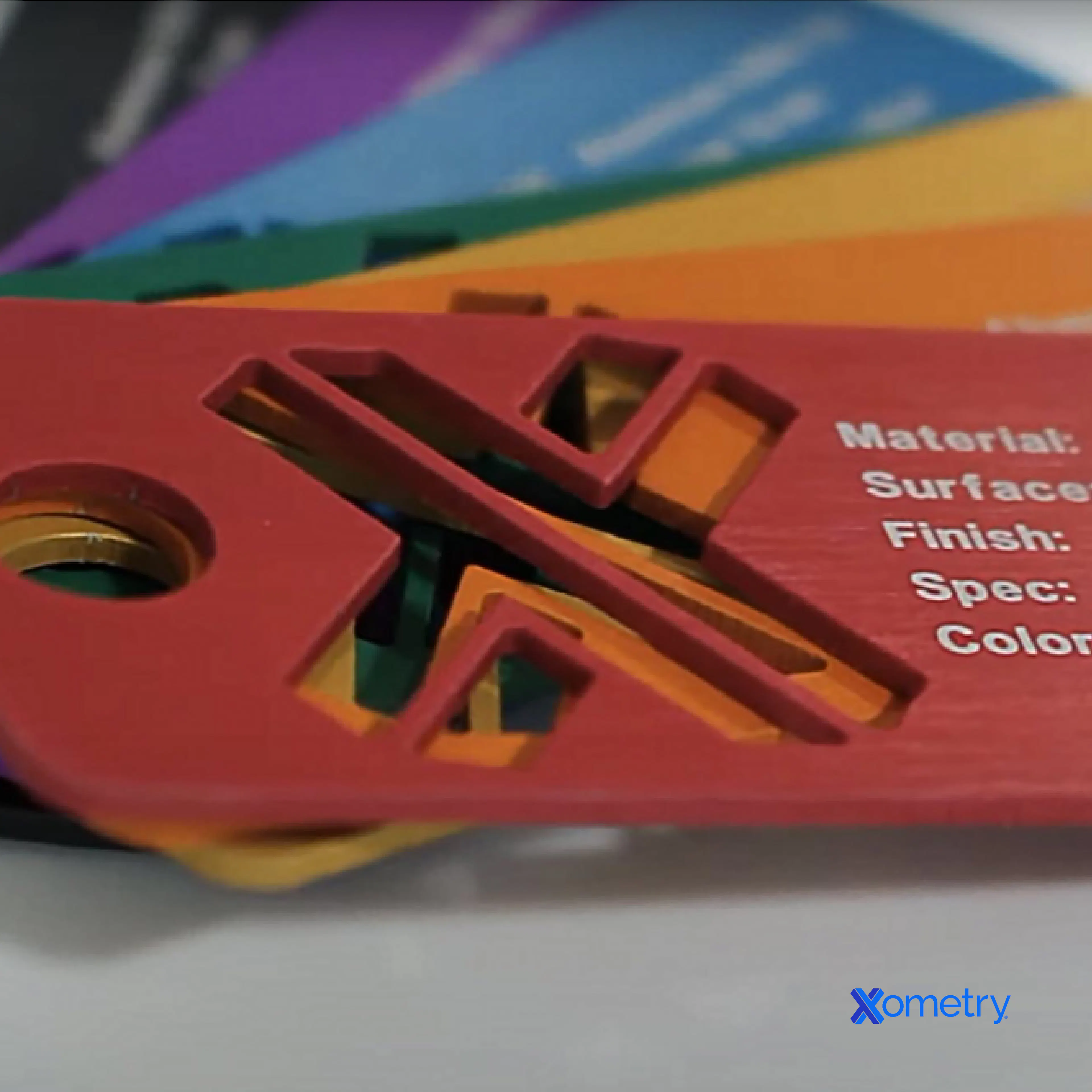

laser engraved parts by Xometry
Laser engraved parts by Xometry
