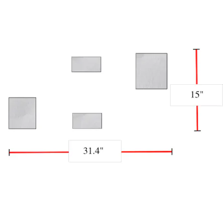

This design has four rectangular parts in a 31.4-inch by 15-inch area. If we pick stainless steel 304 at 0.75 inches thick, we get a single set price of $247.90. Now let's see what happens when we nest these parts even closer together.

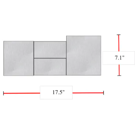

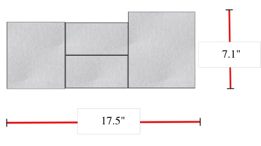

Now almost all of the space between the parts is removed, and they fit within an area of 17.5x7.1 inches. With this change, the price stays the same at $247.90. You may wonder why this change did not make a difference. It has to do with the way our pricing algorithm analyzes the parts to calculate material usage. In short, if the bounding boxes of the individual components cannot occupy the same space, there won't be any benefit. Let's look at an example where the component bounding boxes intersect.

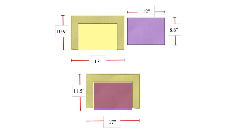

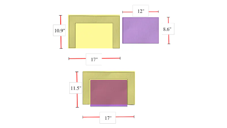

In the example above, the bounding box of the u-shaped part is highlighted in yellow, and the other part's in purple. As you can see, when the components are nested, the enclosing boxes share the same area in the middle, which reduces the material usage overall. When the parts are separate, the total area is 288.5 square inches versus 195.5 square inches when nested. This brings the cost from $479.10 for a set of the parts made in 0.75 thick stainless steel 304 down to $366.80, respectively.
