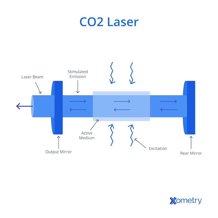

What Laser Cutter Can Be Used for Wood?
Any CO2 or diode laser-equipped cutting machine will work for wood. The key to easy operation is to get further up the laser power list. Think of a minimum of 40 W, and ideally 100+ W.
A strong blower makes a difference; even better if the blower has two outlets. Two blower outlets can target the optics and the cut because wood cutting can be dusty. Onboard blowers in small machines are not necessarily strong enough for the best results, so having a compressor attached will potentially improve your cutting efficiency.
While it's not universally true, wood products are often large. If you want to take on small-furniture production, you will need a bigger table than the bulk of low-priced machines provide to laser-cut wood panels.
