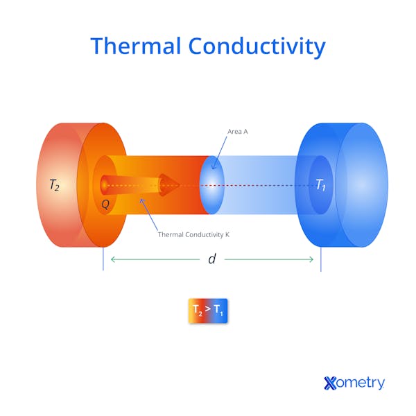

  • Thermal Conductivity, (W/m*K BTU/(hr*ft*F)): One of the three methods of heat transfer, thermal conductivity indicates the ability of a material to conduct or transfer heat. It is determined by the amount of heat flow through a material. This has many application implications in energy efficiency, thermal management, safety, and material selection. Testing Methods: ASTM E1952
Thermal conductivity
