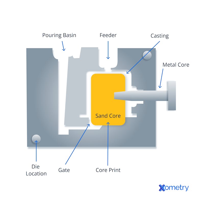

Gravity die casting uses (obviously) gravity to feed the metal into the injection chamber. This can be done automatically, or you can even hand-ladle it. It’s good for lower complexity parts with thick sections, and the method lowers the tooling cost and equipment intricacy. Also, gravity die casting works best with aluminum for parts that are symmetrical and circular.
Gravity die casting diagram
Gravity die casting schematic
