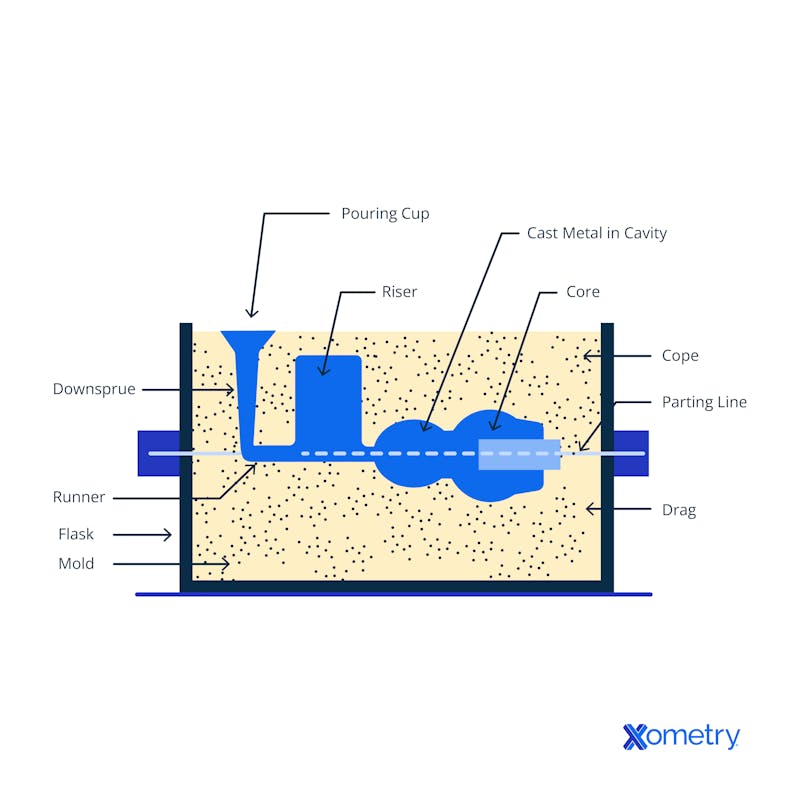

  • Sand Casting: Sand casting is one of the oldest types known and has its roots in metal casting. It creates molds with different types of sand (dry/resin) and can even make large parts from ferrous and non-ferrous metals.
Sand casting diagram
Diagram of sand casting
