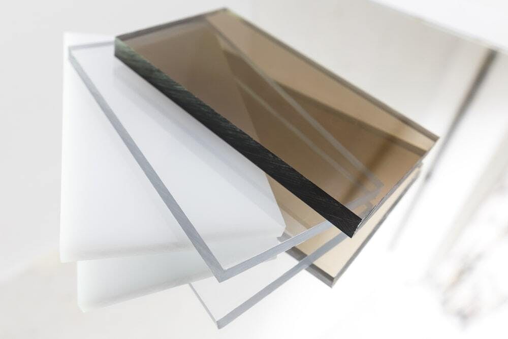

Polycarbonate is an amorphous engineering thermoplastic. It is one of the toughest thermoplastics that can also be made optically clear. Polycarbonate is often used as a lighter and stronger substitute for glass. It is tougher than acrylic (another popular transparent thermoplastic). Polycarbonate panels do have two significant disadvantages, however: they tend to become brittle and yellow when exposed to UV light, and they scratch easily. It must be noted that both of these undesirable properties can be counteracted with specialized coatings. The image below is an example of solid polycarbonate sheets:
Solid brown, white, and transparent polycarbonate sheets.
Brown, white, and transparent polycarbonate sheets.
Image Credit: Cat Us/Shutterstock.com

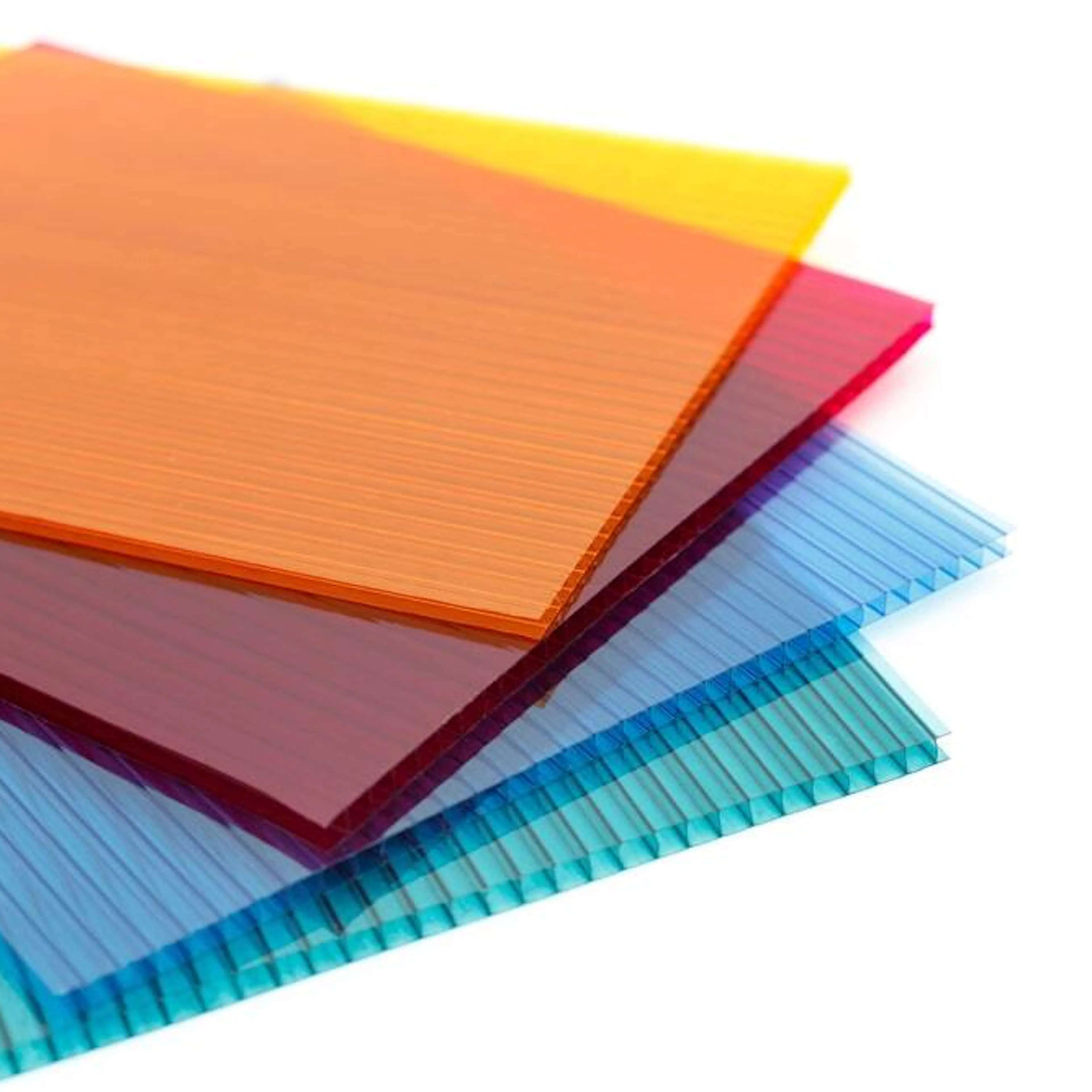

6. Colored/Tinted Polycarbonate
Most types of polycarbonate are available in multiple different sheet colors. As is the case with many thermoplastics, polycarbonate can be colored or tinted. Coloration primarily serves aesthetic purposes. Some serve more functional purposes, though; specialized tints can be added to polycarbonate panels to reflect solar radiation, keeping rooms cooler.
